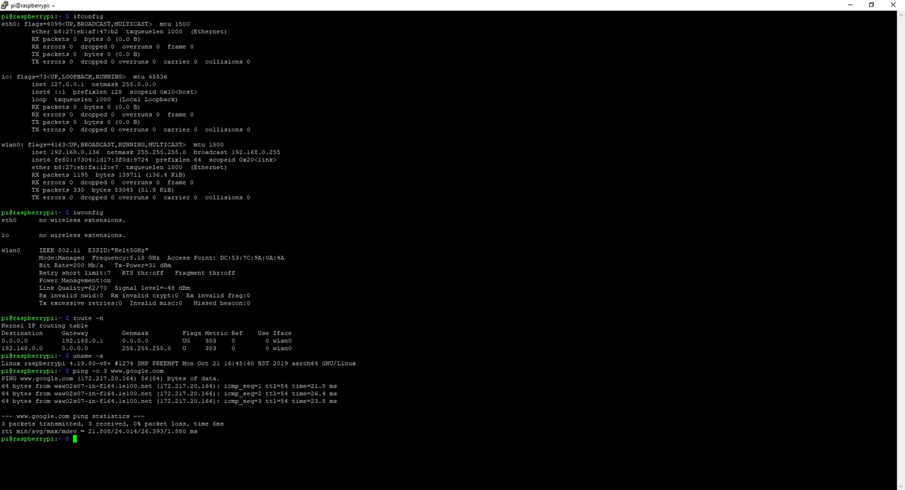

I forgot to mention, 5GHz works fine on Raspbian using default 32-bit kernel, i haven't tested 64-bit kernel yet because it doesn't boot with arm_64bit=1 in config.txt (black screen)
From what i've found 64-bit kernel has to be compiled first. https://www.raspberrypi.org/forums/view ... 0#p1533271
Edit:
I compiled the 64-bit kernel and 5GHz AP works fine.

So, this is quite strange. It's hard to imagine there is any up-stack issue (e.g. with NetworkManager), since (modulo timing race conditions or the like) it shouldn't really care whether 2.4GHz or 5GHz is in use. And as a 64-bit kernel works for you on Raspbian, the issue would not appear to lie there either (the kernels used on the image derive heavily from bcmrpi3_defconfig and bcm2711_defconfig, in any event).
On Raspbian, does "iw reg get" show the same output as on Gentoo? Also, could you please post the content of the file /lib/firmware/brcm/brcmfmac43455-sdio.txt (on Raspbian), and the md5sums of /lib/firmware/brcm/brcmfmac43455-sdio.bin and /lib/firmware/brcm/brcmfmac43455-sdio.clm_blob (in case somehow these are different from the versions in Gentoo)?
Does your Bluetooth mouse also work OK in Raspbian under the 64-bit kernel, without lag? If so, could you please also post the output of "uname -a" on Raspbian? The same chip handles both WiFi and Bluetooth on the RPi3B+, so the issues could well be related (although I can't reproduce them on my RPi3B+ units here, where I often use 5GHz and a BT mouse and keyboard).
Thanks for your continued patience; I'd really like to get to the bottom of this issue.

The mouse lag i mentioned earlier is related to mousepolling, adding "usbhid.mousepoll=0" to "/boot/cmdline.txt" fixes it everytime, i dont think there would be any interference between bluetooth and 5GHz Wi-Fi as bluetooth uses 2.4GHz communication AFAIK..
MD5(/lib/firmware/brcm/brcmfmac43455-sdio.bin)= ebf3cba3cff3c3df5f998414ec661c3b
MD5(/lib/firmware/brcm/brcmfmac43455-sdio.clm_blob)= 4182d09734aae4602d47a53d2970994c
uname -a:
Linux raspberrypi 4.19.80-v8+ #1274 SMP PREEMPT Mon Oct 21 16:45:40 BST 2019 aarch64 GNU/Linux
iw reg get output on Raspbian:
global
country PL: DFS-ETSI
        (2402 - 2482 @ 40), (N/A, 20), (N/A)
        (5170 - 5250 @ 80), (N/A, 20), (N/A), AUTO-BW
        (5250 - 5330 @ 80), (N/A, 20), (0 ms), DFS, AUTO-BW
        (5490 - 5710 @ 160), (N/A, 27), (0 ms), DFS
        (57000 - 66000 @ 2160), (N/A, 40), (N/A)
