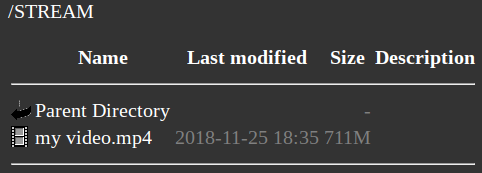

Hello.
I am making a NAS on my little Pi. :)
Here is my problem:
I want to stream video files on there, but the links generated (path to videos) are quite messy.
Here is an example video file:
As you can see, it contains spaces.
But the link generated looks like this:
How could I replace all the "%20" by "-" without renaming the file :shock: ?
Thanks for the help.

To clean up a bit, I used the following:
RewriteEngine on
RewriteCond %{REQUEST_FILENAME} !-d
RewriteCond %{REQUEST_FILENAME}\.mp4 -f
RewriteRule ^(.*)$ $1.mp4
It removes the .mp4 extension from my files. Apache still redirected me to "my_video.mp4" in the autoindex when clicking on links, witch give me a 404-error, so I added this to the footer of my auto-index page:
<script>
document.body.innerHTML = document.body.innerHTML.split(".mp4").join("")
</script>
It removes all of the automaticly generated .mp4 extensions in my page code- witch give me clean links like "/home/stream/my_video".
My initial problem isnt out of the way tho- I want my links to look like "/home/stream/my_video" but I want people to see it in the autoindex page as "My Video".
I tried this:
document.body.innerHTML = document.body.innerHTML.split("_").join(" ")
It removes all of the "_" in my page. It makes my index real clean, but it breaks the links, since its replacing everything in the code. Now, when I click a video link, it redirects me to "my%20video".
How could I modify my javascript code to make it redirect to my_video instead without making the index look crappy again (with "_" instead of spaces?)?
